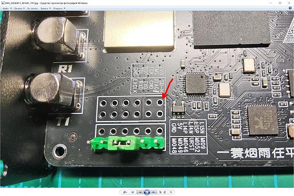

Модернизирован, добавлен джампер переключения на загрузку с карты памяти и выведен на центральную панель через микропереключатель.
Смена прошивки теперь занимает 5 секунд.

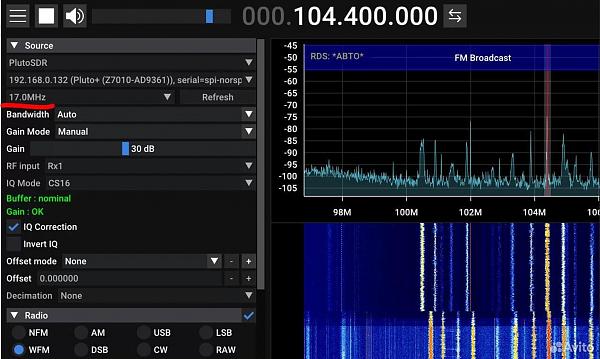

Работает по USB и LAN с SDR++ Tezuki и SDRConsole.

Interfaces:
Please note that all IO levels are 1. 8V.
When using the official firmware for ADI-PlutoSDR, please connect to URST-MI052.
When using Pluto+ firmware and need to support Ethernet, please connect URST-MIO46
When using SD card to boot, please connect SD-H to 1V8
When using JTAG to debug, please connect JTAG# to GND
Please connect EXCLK to GND when using external reference clock input
PTT Key Port:
- PTT drives optocouplers through GPIO0 (MI00), which requires an external relay or control circuit.
DFU KEY:
-At any time, you can press the DFU button and power on PLUTO+ again to enter the DFU mode, but you need to connect the URST jumper to MI052.
Ref CLK input IPEX:
- You can connect a cable to input an external high-precision reference clock for AD9363 through the IPEX interface.
- The main level should not exceed 3. 3V, and the EXCLK jumper needs to be connected to GND to turn off the built-in clock
Calibrate the Frequency of Built-in VCTCXO:
-The frequency of the 40M clock can be fine-tuned by adjusting the adjustable resistor next to the VCTCXO, provided that you have a reference signal source.
Micro-SD:
Support booting via SD card, need to connect SD-H jumper to 1V8.
